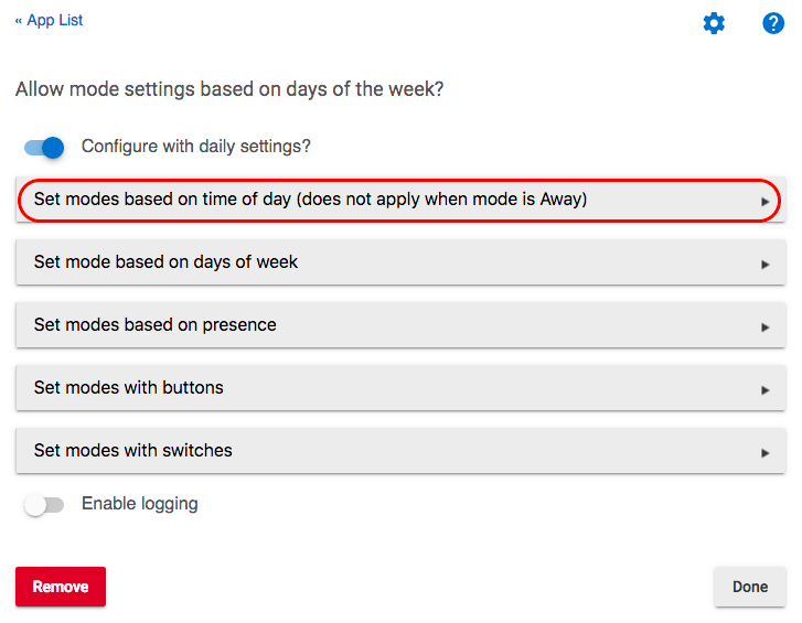

  3. Select "Set modes based on time of day (does not apply when mode is Away)" - Note: As stated, modes will not activate by time of day if the current mode is Away.
